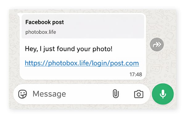

Step 1: A message from someone you trust
GhostPairing begins with a short, casual message designed to spark curiosity, like “Hey I just found your photo!”, followed by a link. The message often comes from a real contact whose account has already been compromised, which makes it feel trustworthy.
URL elements in the link preview, like  /login/post.com or /login/facepost.com, add legitimacy (at least, more legitimacy than a long string of random characters) — bearing some similarities to typosquatting.
Screenshot of a real GhostPairing attack.

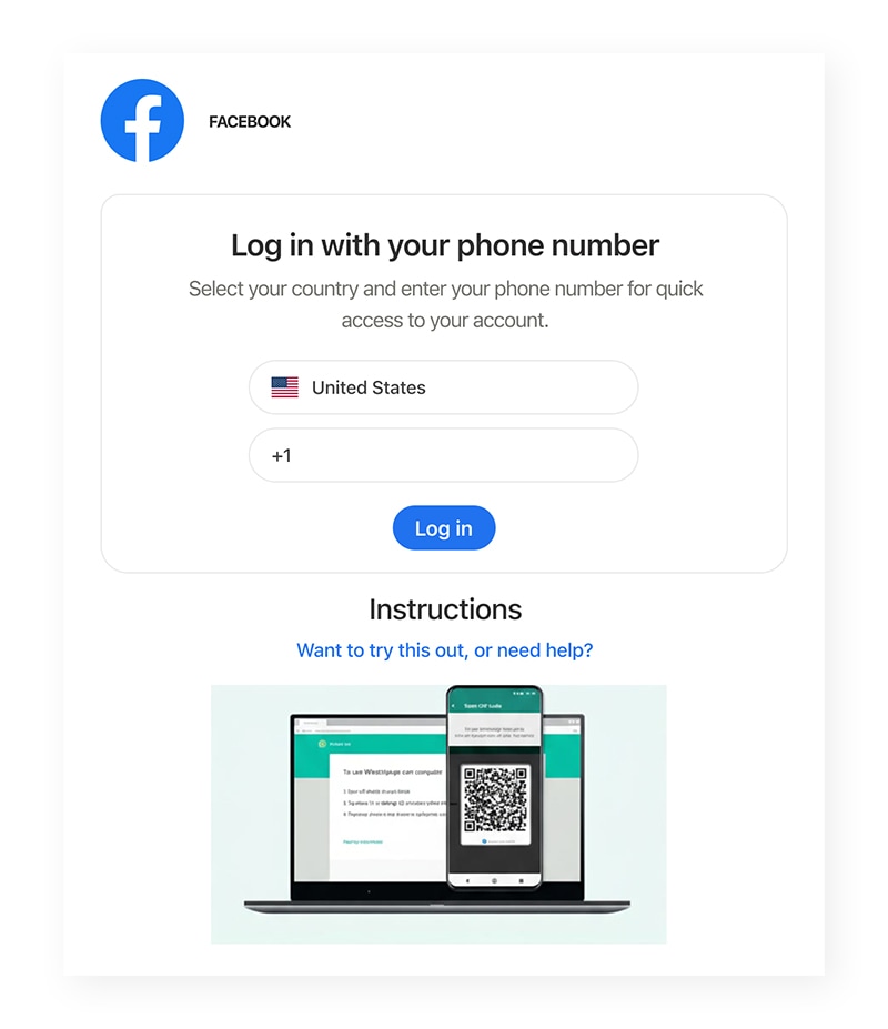

Step 2: A convincing fake login page
If you click the phishing link, you’re taken to a minimalistic login page that resembles Facebook or another Meta platform. There, you are prompted to verify your identity by logging in using your phone number.
The catch? This isn’t a Facebook login page at all: it’s a malicious site that secretly starts WhatsApp’s device-linking process using the phone number you just entered.
A spoofed Facebook login page that triggers a GhostPairing attack.
